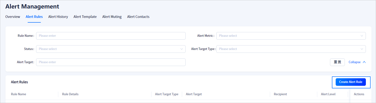

Log in to the OceanBase Cloud console.
In the left-side navigation pane, click Alerts.
On the page that appears, click the Alert Rules tab.
On this tab, click Create Alert Rule.
Specify rule parameters and click Create.
