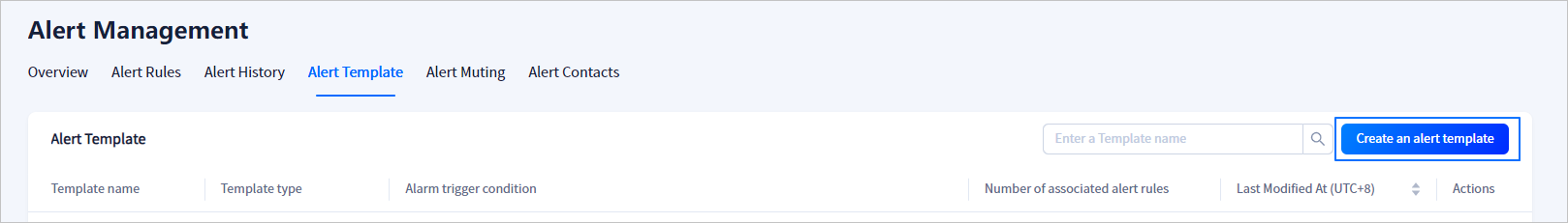

Log in to the OceanBase Cloud console.
In the left-side navigation pane, click Alerts.
On the Alert Management page, click More, and then click Trigger condition template.

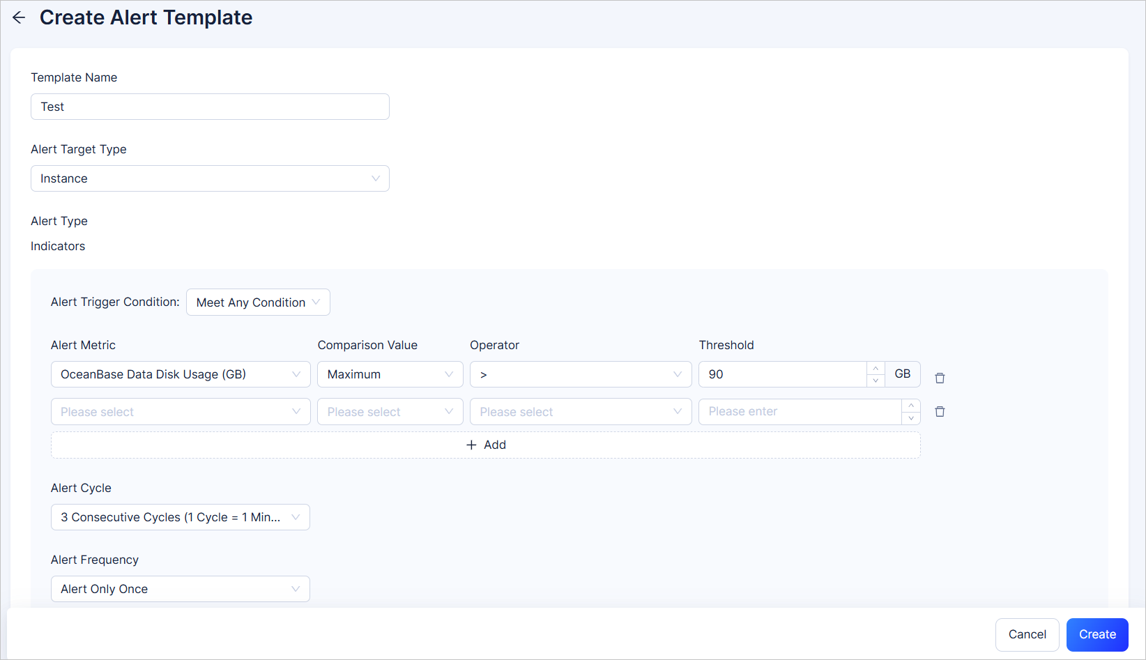

On this tab, click Create Trigger Condition Template.
Configure the template parameters.
ParameterDescriptionTemplate Name The name of the template. Alert Target Type Select Instance as the alert target. Different alert target types correspond to different alert metric options. Alert Type The default value is Metric. Alert Trigger Condition Select an operation mode for multiple metrics. Valid values are Meet Any Condition and Meet All Conditions. Alert Metric Select an alert metric from the Alert Metric drop-down list, and configure the comparison relation, operator, and threshold for the selected alert metric. For more information, see Monitoring metrics for custom alerts.
You can click Add to add more alert metrics. The system determines the operation results of multiple metrics based on the value of Alert Trigger Condition.Alert Cycle The alert detection cycle. The system periodically checks whether the alert meets the trigger conditions based on the specified cycle. Alert Frequency The frequency at which the alert is triggered. Click Create.
