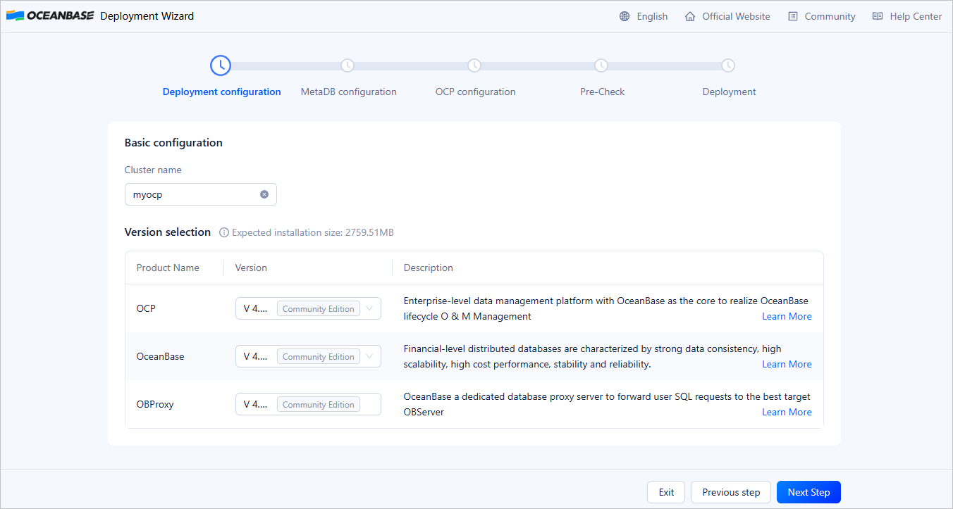

Step 2: Configure deployment information
On the Deployment configuration page, specify the OCP cluster name, which must be different from the name of an existing cluster. You can run the obd cluster list command to query the clusters managed by obd.

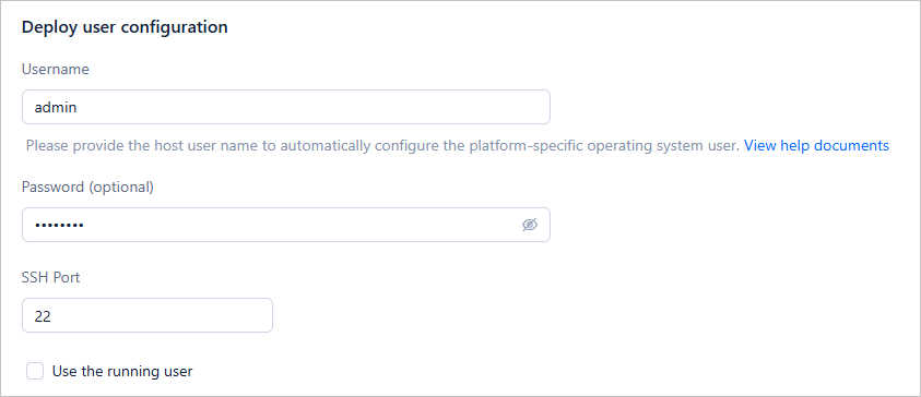

  1. Configure deployment user information.
    In the Deployment user configuration section, configure the user information required for OCP deployment. You only need to specify Username and Password. The specified user must have the permission to execute sudo commands without using the password. If you have enabled password-free login, the password is not required.

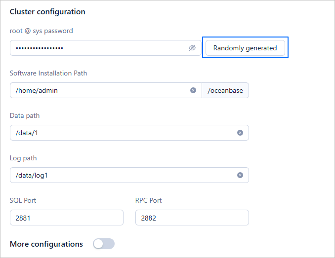

  3. Configure cluster information.
    In the Cluster configuration section, specify the password of the root@sys account, directories, and port numbers required for the MetaDB.
    You can click Randomly generated to generate a random password for the root@sys account. You can modify the default paths displayed on the page. The paths must be absolute paths starting with /. Make sure that the specified paths are empty and you have the read and write permissions on them.

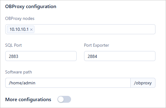

  4. Configure OceanBase Database Proxy (ODP) information.
    In the OBProxy configuration section, specify the IP address of the ODP node, port numbers, and installation path. You can specify only one IP address for the ODP node. By default, the installation path of ODP is the obproxy directory in the home directory of the deployment user. You can specify a custom path, which must be an absolute path starting with /. You must have the read and write permissions on the specified path.

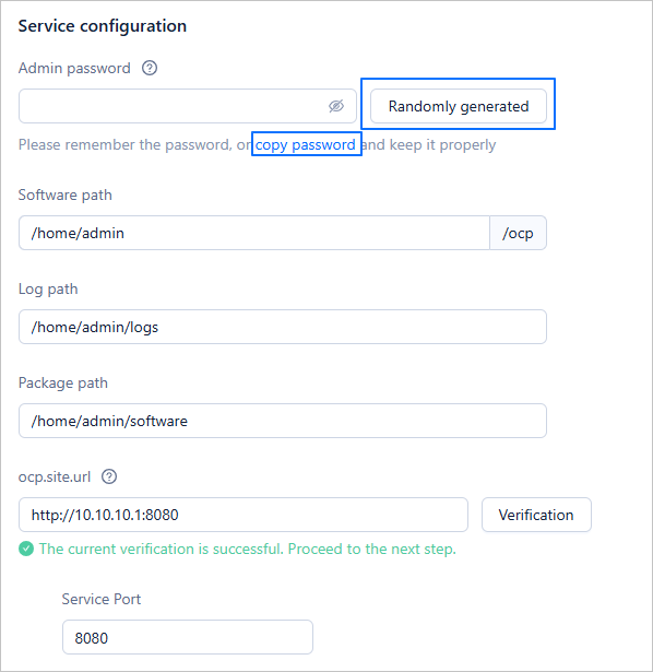

  1. Configure service information.
    In the Service configuration section, specify the OCP login password, paths, URL, and port number. You can click Randomly generated to generate a random password for the admin account. You can modify the default paths displayed on the page. The paths must be absolute paths starting with /. Make sure that the specified paths are empty and you have the read and write permissions on them.

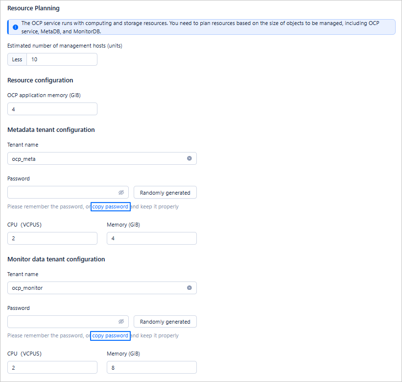

  2. Plan resources.
    OCP consumes computing and storage resources to provide services. In the Resource Planning section, you can allocate resources based on the number of hosts to be managed.
    You can click Randomly generated to generate random passwords for the root users of the tenants.
    Resource planning
Click Next Step to go to the Pre-check page.

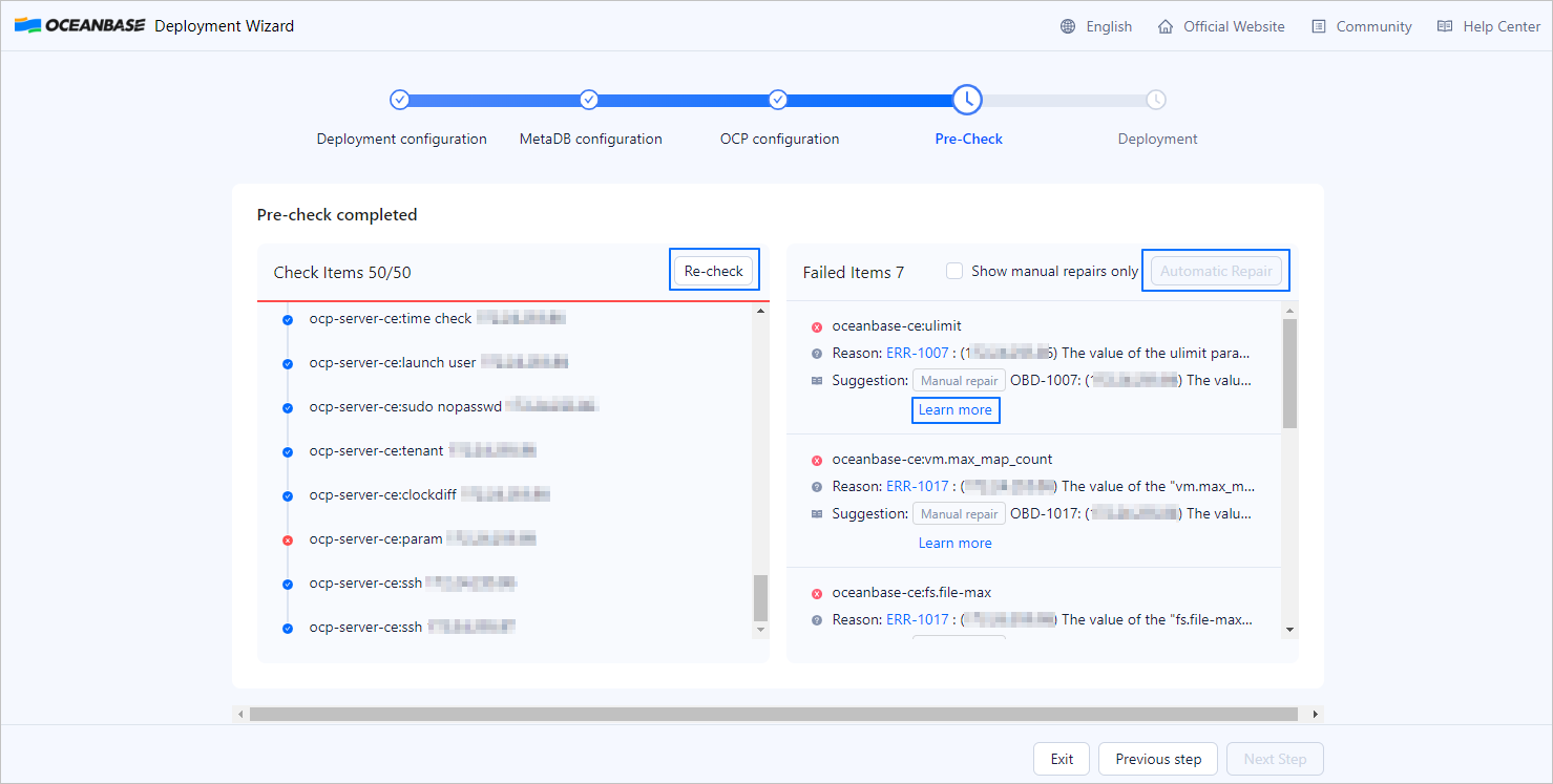

Step 5: Perform a pre-check
On the Pre-check page, you can view all configured information. If you find an error, you can click Previous Step to fix it. After you confirm the information, click Pre-check. Then, the system checks whether your environment meets all the requirements for MetaDB and OCP installation and configuration.
If the pre-check reports an error and the error can be automatically fixed, you can click Automatic Repair to fix the error. You can also click Learn More to fix the reported error by referring to the error code document. After all the errors are fixed, click Re-check to perform a pre-check again.
Pre-check

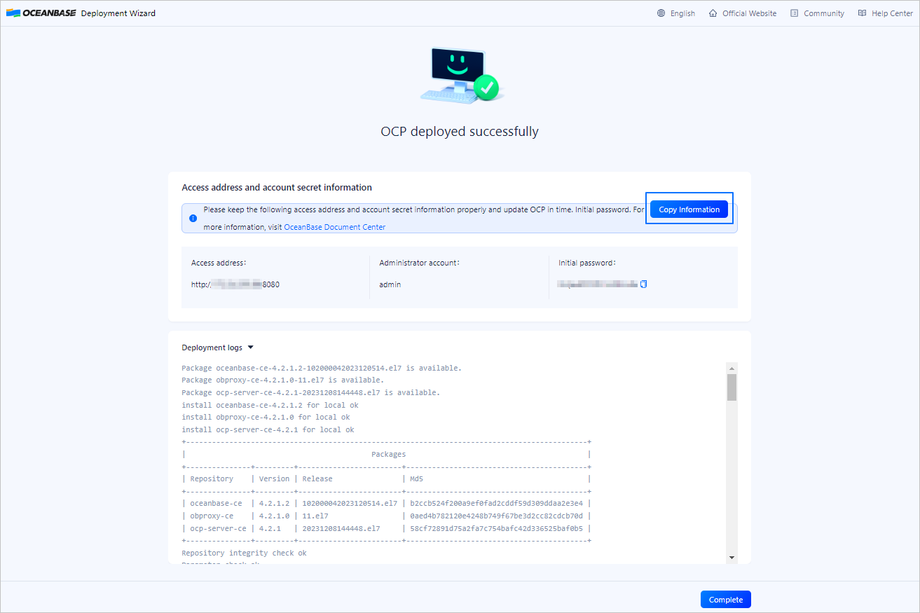

Step 6: Deploy OCP
obd displays deployment logs during the deployment. You can view detailed logs in the Deployment Logs section.
  • If the deployment fails, check the logs to identify the causes, and contact OceanBase Technical Support. You can also submit a question in the Q&A section of the OceanBase community forum, and on-duty engineers will help you fix the issue. After you identify the causes and fix the issue, click Re-deploy. In the dialog box that appears, click OK. Then, the system clears the failed OCP installation environment and re-executes the installer.
  • If the deployment succeeds, click Copy Information to save the OCP URL and login credentials. Then, click Complete to exit.
Deployment
