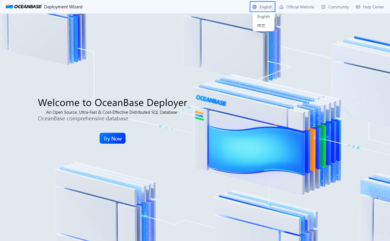

  2. (Optional) To change the display language, click the English icon in the upper-right corner of the page and select a language as needed.
    English
  3. On the GUI, click Try Now to go to the Welcome to the OceanBase Deployment Wizard page. On the page that appears, select OceanBase and supporting tools and click Installation to go to the OceanBase Database deployment page.

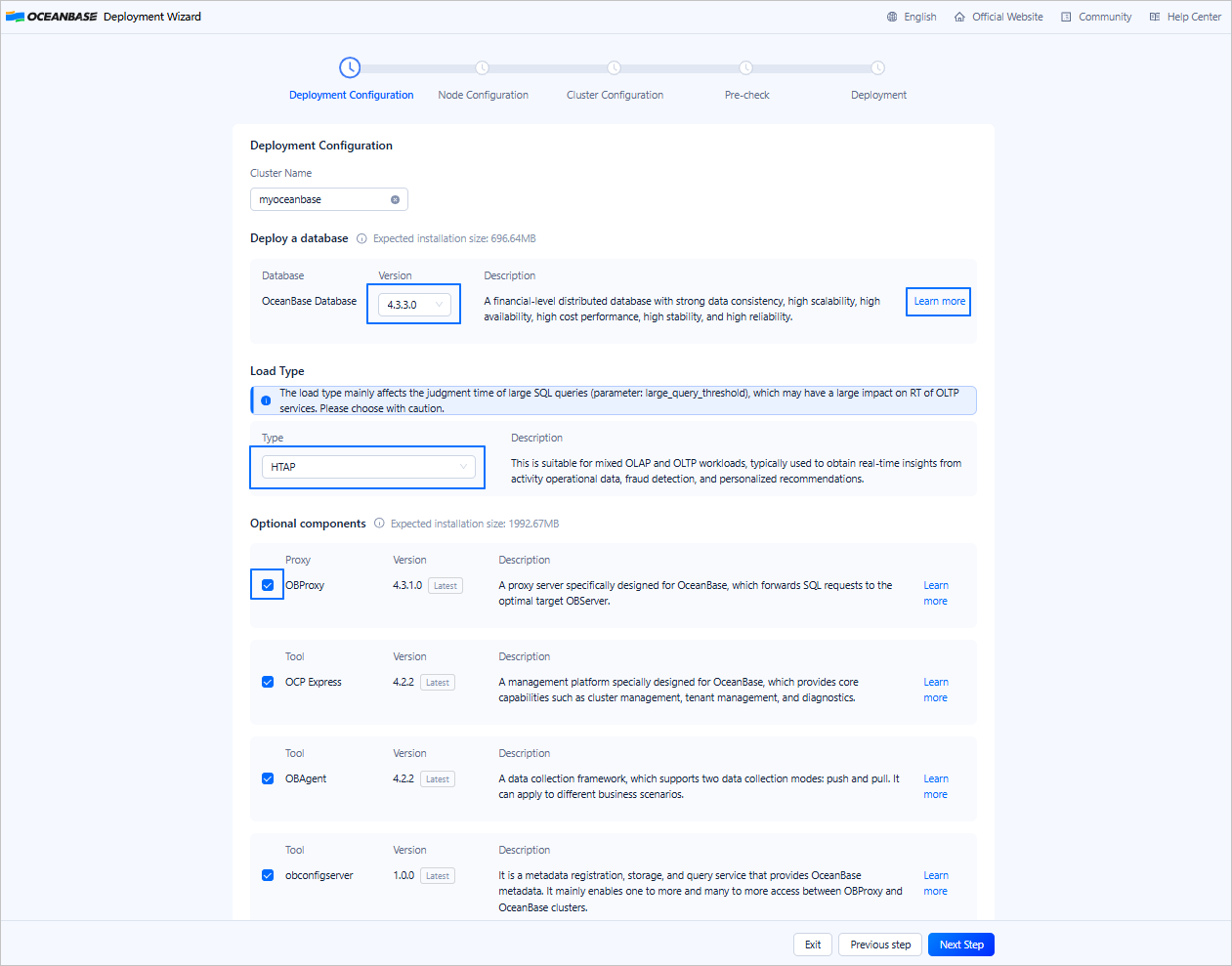

Step 2: Configure deployment information
On the Deployment Configuration page, specify the cluster name, load type, and components to deploy.
Deployment configuration
Section
Deployment Configuration Cluster Name indicates the name of the cluster to be deployed by using obd, which must be unique. The default value is myoceanbase. You can specify a custom cluster name. The cluster name can contain letters, digits, and underscores (_). It must start with a letter and end with a letter or digit, and must be 2 to 32 characters in length. You can run the obd cluster list command to view the clusters managed in obd.
Deploy a database You can select an OceanBase Database version from the Version drop-down list and click Learn more to view its documentation.
Load Type You can select a load type for the OceanBase cluster from the Type drop-down list and view its applicable scenarios in the Description column.
Optional components By default, only ODP is selected. You can deselect the components that you do not want to deploy under Optional components. You can also click Learn more in the row of a component to view its documentation.
OCP Express is automatically selected along with OBAgent. When you deselect OBAgent, OCP Express is also automatically deselected.
Click Next Step to go to the Node Configuration page.

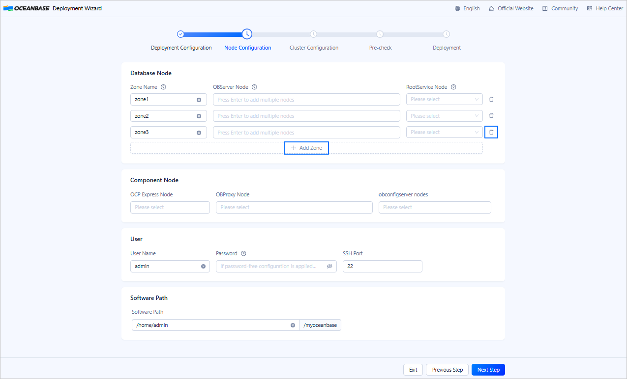

Step 3: Configure node information
On the Node Configuration page, configure the database and component nodes, and specify the user information and software installation path.
Node configuration
Section
Parameter
Database Node Zone Name The name of a zone in OceanBase Database. You can specify a custom zone name. The zone name can contain letters, digits, and underscores (_). It must start with a letter and end with a letter or digit, and must be 2 to 32 characters in length. In an OceanBase cluster that consists of multiple zones, the cluster must have a zone that shares the same region as that of the primary zone. You can click + Add Zone to add a zone or the Delete icon next to a zone to remove the zone.
OBServer Node The IP address of an OBServer node in the OceanBase cluster. After you specify the IP address of an OBServer node, you can press Enter to specify the IP address of another OBServer node.
RootService Node You can select an IP address specified in the OBServer Node column from the RootService Node drop-down list to specify the OBServer node to be used as the RootService node of the OceanBase cluster. In an OceanBase cluster that has multiple replicas, you must specify a RootService node for each zone.
Component Node OCP Express Node You can select the IP address of an OBServer node from the drop-down list or enter the IP address of a new node. You can select or enter only one IP address.
OBProxy Node You can configure multiple nodes. You can select the IP address of an OBServer node from the drop-down list or enter the IP address of a new node. After you specify the IP address of a node, you can press Enter to specify the IP address of another node.
obconfigserver nodes You can configure multiple nodes. You can select the IP address of an OBServer node from the drop-down list or enter the IP address of a new node. After you specify the IP address of a node, you can press Enter to specify the IP address of another node. If you want to deploy obconfigserver on multiple nodes, configure load balancing in advance and specify the vip_address and vip_port parameters on the GUI. To specify the parameters, go to the Cluster Configuration page and enable More Configurations in the Component Configuration section.
User User Name The username used to deploy the OceanBase cluster. The default value is the name of the user who started the current process. You can specify a custom username.
Password The login password of the user specified by User Name. If password-free access is not configured for the nodes, you must enter the password of the specified user.
SSH Port The SSH port number. The default value is 22. You can specify a custom port number.
Software Path Software Path The software path. The default value is the home directory of the deployment user. You can change the path as needed. After you specify this parameter, the myoceanbase folder is created in the specified directory.
Click Next Step to go to the Cluster Configuration page.

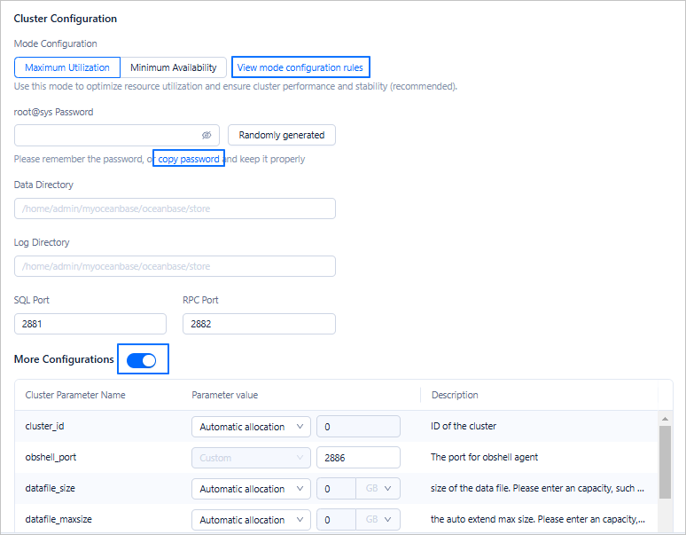

Step 4: Configure cluster information
On the Cluster Configuration page, configure related cluster information, including the password of the administrator user in the sys tenant (root@sys), data directory, log directory, and ports and parameters of OceanBase Database and its components.
  1. Cluster configuration
    Parameter
    Mode Configuration Valid values: Maximum Utilization (recommended) and Minimum Availability. The Maximum Utilization mode maximizes resource utilization to ensure cluster performance and stability. In Minimum Availability mode, minimum resources required for the normal running of the cluster are configured. For more information about the two modes, see Mode configuration rules.
    root@sys Password You can click Randomly generated to generate a random password or enter a custom password. The password must meet the following complexity requirements:
    • It must be 8 to 32 characters in length.
    • It must contain characters of at least three of the following types: digits (0 to 9), uppercase letters (A to Z), lowercase letters (a to z), and special characters. Special characters are ~!@#%^&*_-+=|(){}[]:;,.?/.
    You can click copy password to copy the password and save it.
    Data Directory By default, the data directory is in the software path configured on the Node Configuration page. The data directory must be an absolute path starting with a forward slash (/). You can change the data directory. Make sure that the specified directory is empty.
    Log Directory By default, the log directory is in the software path configured on the Node Configuration page. The log directory must be an absolute path starting with a forward slash (/). You can change the log directory. Make sure that the specified directory is empty.
    SQL Port The SQL port number. The default value is 2881. You can specify a custom port number ranging from 1025 to 65535. Make sure that the specified port is not occupied.
    RPC Port The port number used for the remote access protocol. The default value is 2882. You can specify a custom port number ranging from 1025 to 65535. Make sure that the specified port is not occupied.
    More Configurations You can enable More Configurations to view more cluster parameters. You can retain the default settings or modify the settings.
    After you enable More Configurations, you can configure the scenario parameter to specify a load type for the cluster. The default value of this parameter is htap.

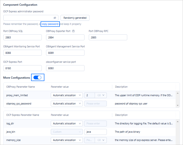

  2. Component configuration
    Parameter
    OCP Express Admin Password The login password of the administrator account of OCP Express. You can click Randomly generated to generate a random password or enter a custom password. The password must meet the following complexity requirements:
    • It must contain two characters of each of the following four types: digits (0 to 9), uppercase letters (A to Z), lowercase letters (a to z), and special characters. Special characters are ~!@#%^&*_-+=`|(){}[]:;',.?/.
    Port OBProxy SQL The listening port of ODP. Default value: 2883. You can specify a custom port number ranging from 1025 to 65535. Make sure that the specified port is not occupied.
    OBProxy Exporter Port The exporter port of ODP. It is used for Prometheus to pull monitoring data from ODP. Default value: 2884. You can specify a custom port number ranging from 1025 to 65535. Make sure that the specified port is not occupied.
    Port OBProxy RPC The RPC port of ODP. Default value: 2885. You can specify a custom port number ranging from 1025 to 65535. Make sure that the specified port is not occupied.
    OBAgent Monitoring Service Port The monitoring service port of ODP. Default value: 8088. You can specify a custom port number ranging from 1025 to 65535. Make sure that the specified port is not occupied.
    OBAgent Management Service Port The management service port of ODP. Default value: 8089. You can specify a custom port number ranging from 1025 to 65535. Make sure that the specified port is not occupied.
    OCP Express Port The HTTP port for accessing OCP Express. Default value: 8180. You can specify a custom port number ranging from 1025 to 65535. Make sure that the specified port is not occupied.
    obconfigserver service port The listening port of obconfigserver. Default value: 8080. You can specify a custom port number ranging from 1025 to 65535. Make sure that the specified port is not occupied.
    More Configurations You can enable More Configurations to view more component parameters. You can retain the default settings or modify the settings.
    If multiple nodes are configured for obconfigserver nodes on the Node Configuration page, you must enable More Configurations and specify the vip_address and vip_port parameters. Otherwise, an error occurs during the pre-check.
    Click Next Step to go to the Pre-check page.

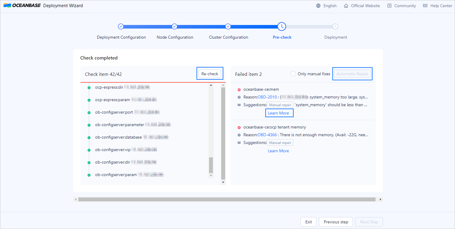

Step 5: Perform a precheck
On the Pre-check page, confirm all the configuration information. If any information is incorrect, you can click Previous Step to modify the information. After you confirm that all the information is correct, click Pre-check.
If the precheck reports an error and the error can be automatically fixed, you can click Automatic Repair to fix the error. You can also click Learn More to fix the reported error by referring to the error code document. After all the errors are fixed, click Re-check to perform a pre-check again.
Precheck
After the pre-check is passed, click Deploy to start the deployment.

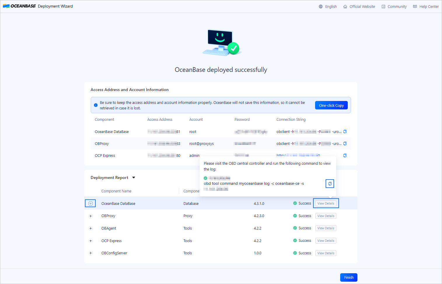

Deploy
On the deployment page:
  • After the deployment succeeds, you can copy the displayed connection string and use it to connect to the corresponding component. On the CLI, you can copy the connection string corresponding to OceanBase Database and use it to connect to the OceanBase cluster as the root@sys user, or copy the connection string corresponding to ODP and use it to connect to ODP as the root@proxysys user.
  • Click the connection string of OCP Express to go to the login page of OCP Express. Log in with the account username and password provided on the deployment page, and then change the password. Then, you can manage the cluster on the GUI.
    In Alibaba Cloud or other cloud environments, the program may fail to obtain a public IP address but return an intranet IP address. You must use a correct public IP address to access the GUI.
  • In the Deployment Report section, click the Expand icon before a component to view its deployment logs on the GUI. Find the component and click View Details. Then, you can click the Copy icon next to a command to copy the command and run the command on the central control server to view the log location of the component.
  • Click One-click Copy to save the access address and account information of the OceanBase cluster. Then, click Finish to exit.
Notice
To deploy multiple clusters, click Finish on the GUI to end the current obd process and then run the obd web command to start the deployment of another cluster.
