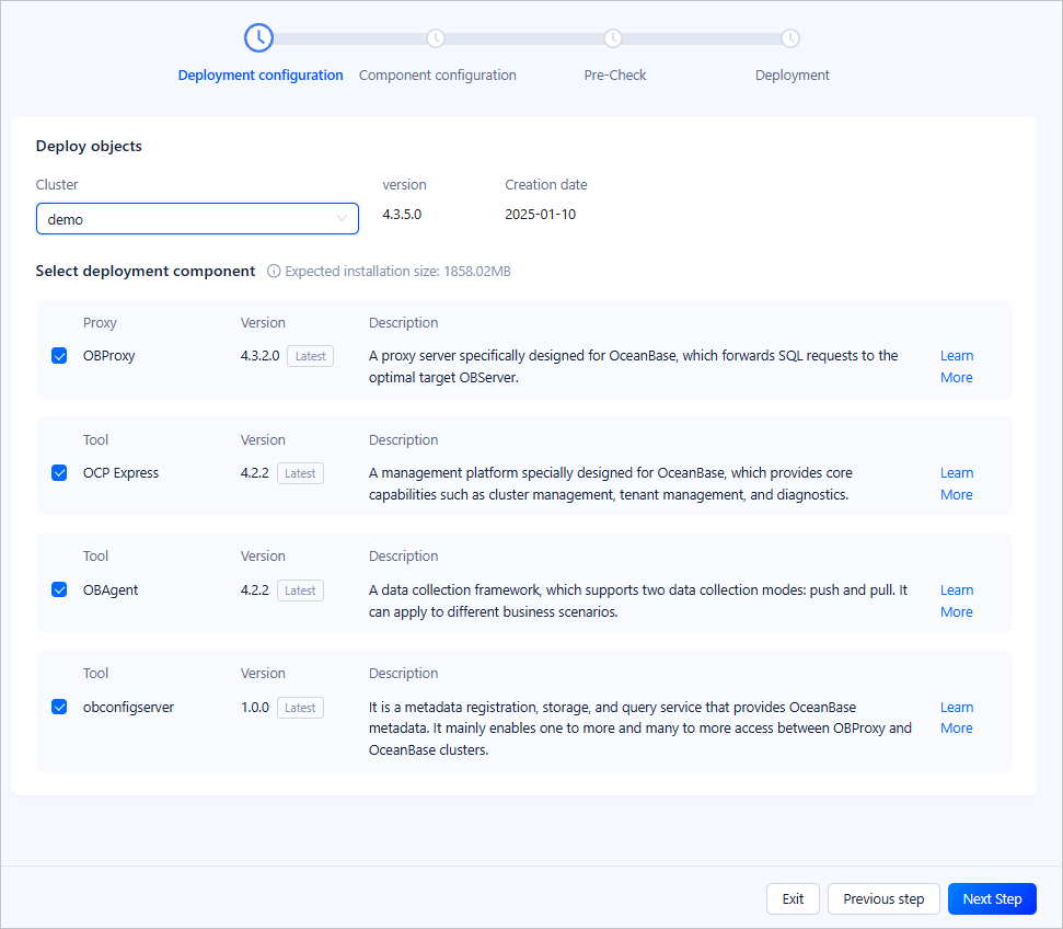

Step 2: Deployment configuration
On the Deployment configuration page, select the components to install, as shown in the following figure:
Section
Deploy objects Select a cluster to which you want to add components from the Cluster drop-down list. The Cluster drop-down list contains all clusters in the running state that are managed by obd. You can click the name of a cluster to select it.
Select deployment component This section displays all components deployed in the cluster and those to install. Select the components that you want to install. The latest versions of the selected components will be installed. You can click Learn More in the row of a component to view its documentation.
If OceanBase Cloud Platform (OCP) Express and OceanBase Agent (OBAgent) are not installed in the cluster, you can select OBAgent, and OCP Express is selected along with OBAgent automatically. When you deselect OBAgent, OCP Express is automatically deselected.
Click Next Step in the lower-right corner to go to the Component configuration page.

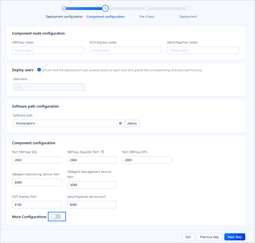

Step 3: Component configuration
On the Component configuration page, configure nodes, ports, and other information of the components to install, as shown in the following figure:
Section
Component node configuration Configure nodes for the selected components. After you specify the IP address of a node for a component, you can press Enter to specify the IP address of another node for the component. You can configure multiple ODP and Config Server nodes, but only one OCP Express node.
Deploy users By default, the username is the one used to deploy the current cluster. The username cannot be modified. Make sure that the user exists on all servers and has required privileges on the specified directory.
Software path configuration By default, the software path is the installation path of the current cluster. You can modify the path. The software path must be an absolute path beginning with a slash (/).
Component configuration Configure ports for the selected components. For more information, see the Step 4: Cluster configuration section in Deploy an OceanBase cluster on the GUI.
More Configurations You can enable More Configurations to view more cluster parameters. You can retain the default settings or modify the settings.
If multiple nodes are configured in the Config Server Node section on the Component configuration page, you must enable More Configurations and specify the vip_address and vip_port parameters. Otherwise, an error occurs in the pre-check.
Click Next Step in the lower-right corner to go to the Pre-Check page.

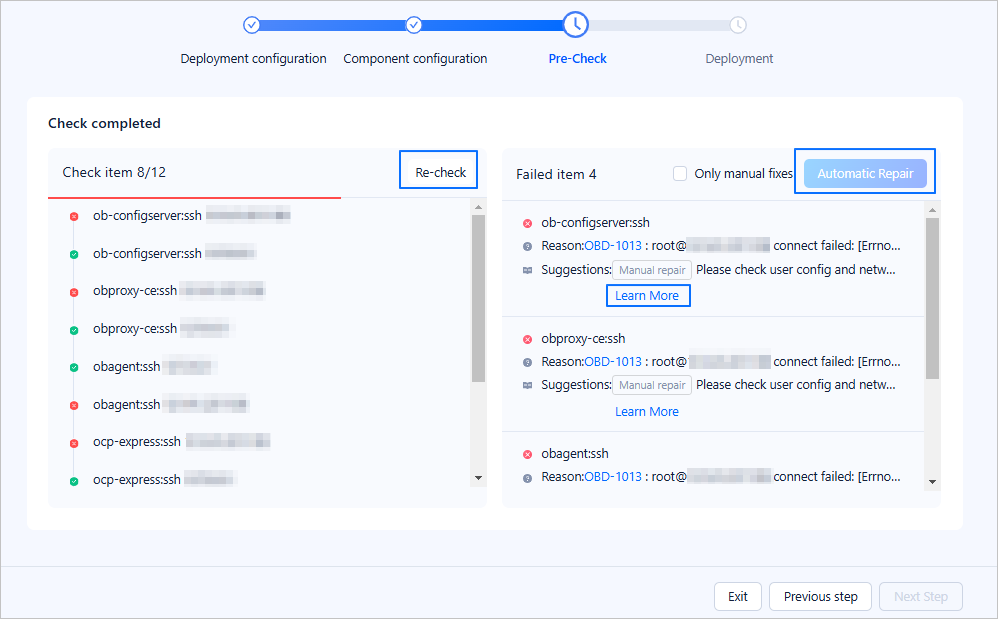

Step 4: Pre-Check
On the Pre-Check page, confirm all the configuration information. If any information is incorrect, you can click Previous step to modify the information. After you confirm that all the information is correct, click Pre-Check.
If the pre-check reports an error, and the error can be automatically fixed, you can click Automatic Repair to fix the error. You can also click Learn more to fix the reported error by referring to the error code document. After all the errors are fixed, click Re-check to perform a pre-check again.
Pre-check
After the pre-check is passed, click Deployment to start the deployment.

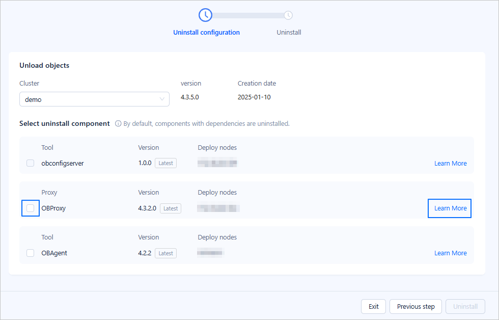

Step 2: Uninstallation configuration
On the Uninstall configuration page, select the components to uninstall, as shown in the following figure:
Section
Unload objects Select a cluster for which you want to uninstall components from the Cluster drop-down list. The Cluster drop-down list contains all clusters in the running state that are managed by obd. You can click the name of a cluster to select it.
Select uninstall component This section displays all components that you can uninstall from the cluster. You can select the components that you want to uninstall. By default, all components are selected. You can click Learn More in the row of a component to view its documentation.
  • By default, obd uninstalls components dependent on each other at a time. For example, when you select OBAgent or ODP, OCP Express is automatically selected, and when you deselect OCP Express, OBAgent or ODP is automatically deselected.
  • You cannot uninstall Config Server.
Click Uninstall in the lower-right corner. In the dialog box that appears, click OK to go to the Uninstall page.

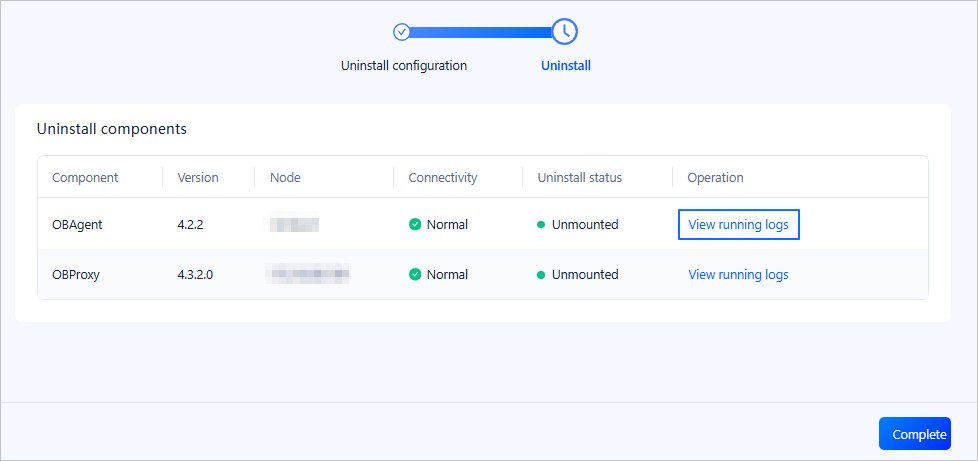

Step 3: Uninstallation
On the Uninstall page, you can view the uninstallation progress and results. The Status column indicates whether the uninstallation is successful. You can move your pointer on View running logs in the Actions column to view the uninstallation logs of a component.
Uninstall results
The following table describes possible uninstallation results and supported operations.
Connectivity
Uninstall status
Operation
Checking To be uninstalled Wait for the system to uninstall the component.
When you uninstall OBAgent and OCP Express at a time, OBAgent enters the Pending state if the uninstallation of OCP Express fails. The system uninstalls OBAgent only after OCP Express is uninstalled or forcibly removed.
Normal Unmounting The system is uninstalling the component. You can move your pointer over View running logs in the Actions column to view the uninstallation logs of the component.
Uninstall Failed Move your pointer over the prompt icon next to Uninstall failed to view the failure cause. You can perform the following operations:
  • Move your pointer over View running logs in the Actions column to view the uninstallation logs of the component.
  • Click Retry in the Actions column. After reconfirmation, the system attempts to uninstall the component again.
  • Click Force Uninstall in the Actions column. After reconfirmation, the system forcibly uninstalls the component.
Unmounted Move your pointer over View running logs in the Actions column to view the uninstallation logs of the component.
Unable to connect Cannot Be Uninstalled Move your pointer over the prompt icon next to Unable to uninstall to view the failure cause. You can click Force Removal in the Actions column. After reconfirmation, the system attempts to uninstall the component again. The Force Removal operation only cancels the dependency between OceanBase Database and the component, without uninstalling the component from the server.
Removing Wait for the system to remove the component.
Removed Successfully You do not need to perform any operation.
