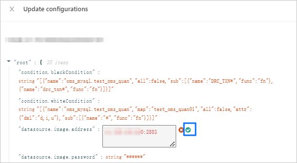

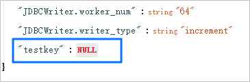

    1. In the Update Configuration dialog box, hover the pointer over the blank area next to the root parameter and click the Add icon.
    2. Specify the Key Name field and click the check mark.
    3. In the Update Configuration dialog box, find the new key. The default value of a new key is NULL.
    4. Hover the pointer over the new parameter and click the Edit icon that appears. Modify the parameter value and click the check mark.

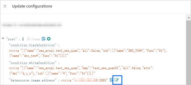

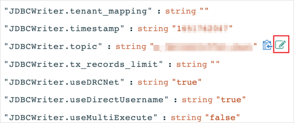

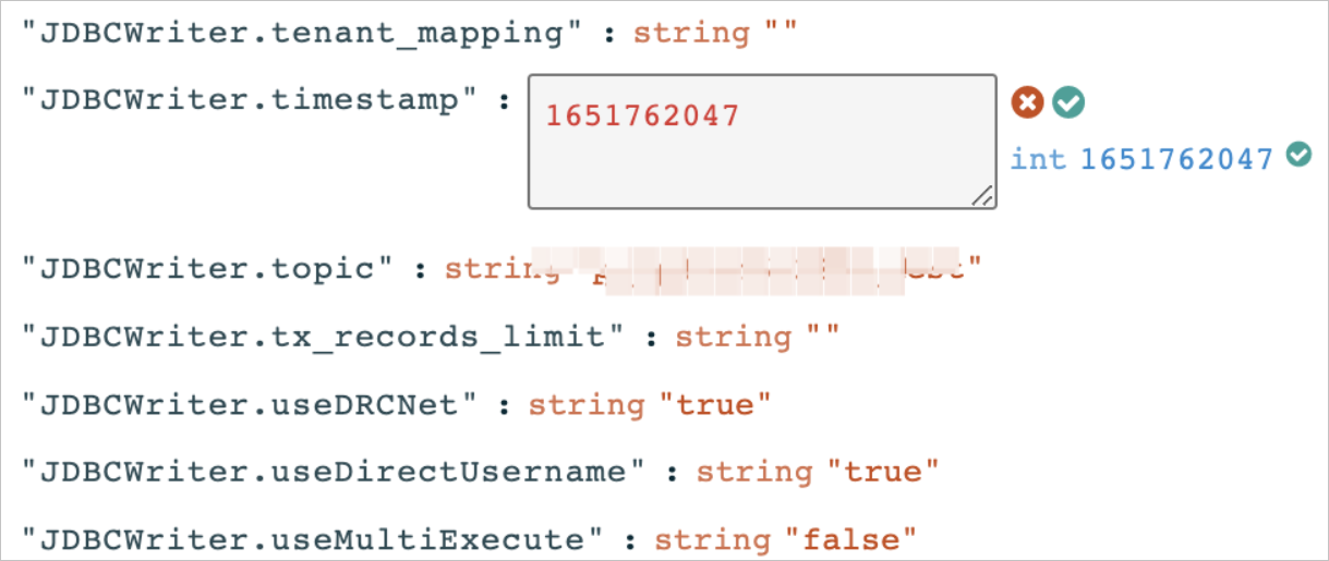

    To update the configurations of a checker, perform the following operations:
    1. In the Update Configurations dialog box, hover the pointer over the parameter to be modified and click the Edit icon that appears.
      Edit
    2. Modify the value in the text box and then click the check mark.
      Click the green check mark to update the value, or the red cross mark to cancel the modification.
      Confirm
  7. In the Update Configuration dialog box, click Update.
