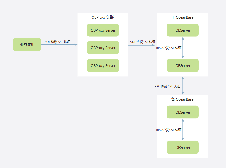

Scenarios
- End-to-end SSL authentication: Use SSL authentication for the entire connection chain from business applications to OBProxy to OceanBase.
- OBProxy-specific SSL authentication: Enable SSL authentication for OBProxy separately, allowing SSL authentication for the connection from business applications to OBProxy.
- OceanBase-specific SSL authentication: Enable SSL authentication for OceanBase separately, allowing SSL authentication for the connection from business applications to OceanBase when OBProxy is not present.
The following diagram shows the end-to-end SSL authentication between OceanBase and OBProxy:

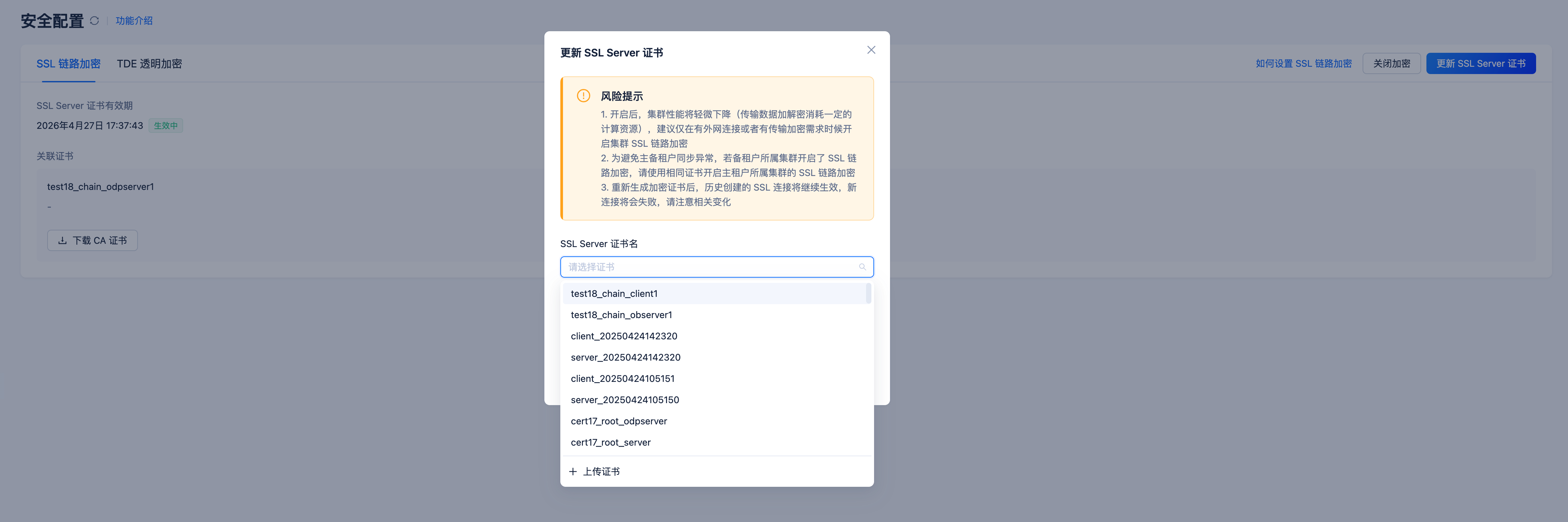

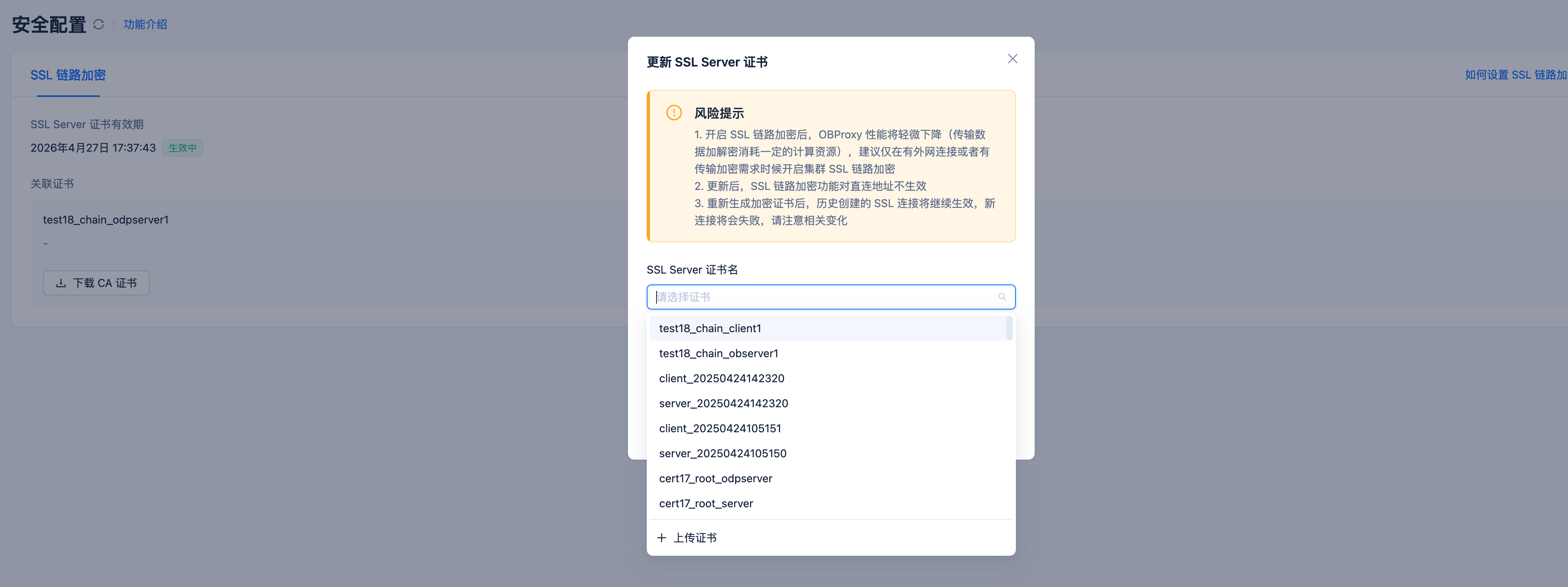

Step 1: Upload the certificate group
On the certificate management page of OCP, upload the CA root certificate, server certificate, and server private key as a certificate group.
Step 2: Enable SSL encryption
On the security configuration page of OceanBase Database and OBProxy, enable SSL encryption for OceanBase Database and OBProxy.
