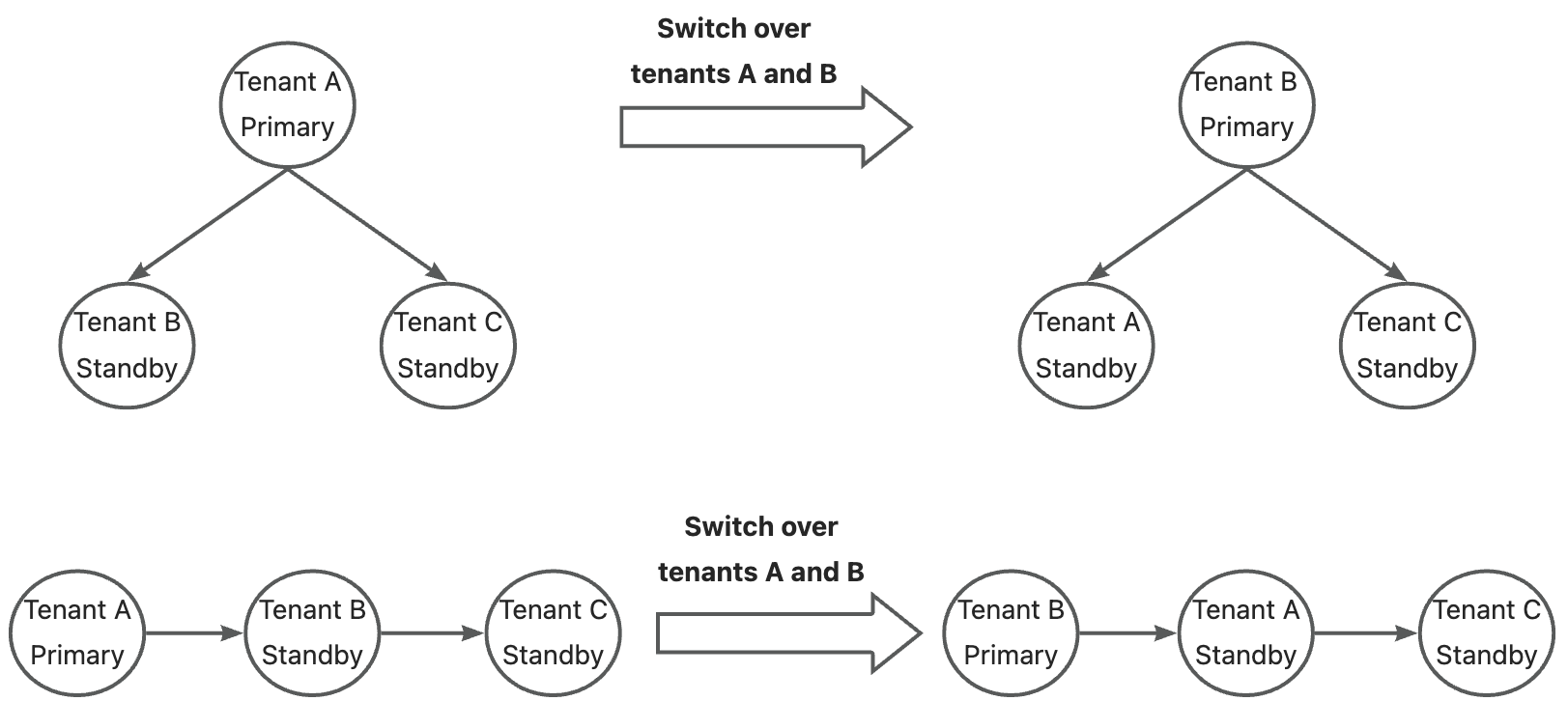

Switchover
After a switchover, to maintain the same topology, the other standby tenants under the original primary tenant switch to the new primary tenant, and the other standby tenants under the new primary tenant switch to the new standby tenant. In other words, only the primary and standby tenants involved in the switchover operation are exchanged, while the positions of other tenants remain unchanged. The following figure shows an example.
Switchover
  • The OceanBase Database version is V4.2.0.0 or later.
  • The clusters where the primary and standby tenants respectively reside are online.
  • The primary and standby tenants are in the NORMAL state and the log transmission status (sync_status) of the standby tenant is NORMAL.
  • The replicas of all log streams of the standby tenant are online.
  • The tenant role (tenant_role) of the primary tenant is PRIMARY.
  1. View the primary/standby relationship of the standby tenant:
    obd cluster tenant show clusterB -g
    The returned results are as follows:
    |                                                                                     tenant base info                                                                                    |
    | tenant_name | tenant_type | compatibility_mode | primary_zone | max_cpu | min_cpu | memory_size | max_iops            | min_iops            | log_disk_size | iops_weight | tenant_role |
    | sys         | SYS         | MYSQL              | RANDOM       | 1.0     | 1.0     | 2.0G        | 9223372036854775807 | 9223372036854775807 | 2.0G          | 1           | PRIMARY     |
    | B_a         | USER        | MYSQL              | RANDOM       | 2.0     | 2.0     | 4.0G        | 10000               | 10000               | 5.0G          | 2           | STANDBY     |
    |                                                                   standby tenant standby info                                                                   |
    | standby_tenant_name | tenant_status | sync_status | sync_scn_timestamp         | err_code | error_comment | switchover_status | switchover_epoch | log_mode     |
    | B_a                 | NORMAL        | NORMAL      | 2023-09-14 09:43:00.199589 | 0        |               | NORMAL            | 0                | NOARCHIVELOG |
    |                                                                                         standby tenant's primary info                                                                             |
    | standby_tenant_name | primary_tenant_info                                                                                                                                                         |
    | B_a                 | IP_LIST=10.10.10.1:2881;10.10.10.2:2881;10.10.10.3:2881,USER=standbyro@A_a,PASSWORD=******,TENANT_ID=1002,CLUSTER_ID=1694680744,COMPATIBILITY_MODE=MYSQL,IS_ENCRYPTED=false |
    query primary-standby relation ok
    primary-standby relation topology graph
    clusterA:A_a
    └── clusterB:B_a
  2. Run the switchover command for the standby tenant:
    obd cluster tenant switchover clusterB B_a --tenant-root-password=******
  3. View the primary/standby relationship of the original standby tenant again:
    |                                                                                     tenant base info                                                                                    |
    | B_a         | USER        | MYSQL              | RANDOM       | 2.0     | 2.0     | 4.0G        | 10000               | 10000               | 5.0G          | 2           | PRIMARY     |
    clusterB:B_a
    └── clusterA:A_a
    As show in the returned results, the tenant_role value of the original standby tenant changes to PRIMARY and the primary/standby relationship topology is updated.
