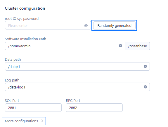

  3. Set cluster parameters.
    In the Cluster configuration section, set cluster parameters, as shown in the following figure.
    Cluster Configuration
    Parameter
    root@sys Password Enter a custom password or click Randomly Generate to generate a random password. The password must meet the following complexity requirements:
    • It must be 8 to 32 characters in length.
    • It must contain characters of at least three of the following types: digits (0 to 9), uppercase letters (A to Z), lowercase letters (a to z), and special characters. Special characters are ~!@#%^&*_-+=|(){}[]:;,.?/
    Software Installation Path The installation path for MetaDB, which is by default the oceanbase directory in the home directory of the user who performs the deployment. You can specify a custom path, but you must have the read and write permissions for the corresponding directory.
    Data path The data storage path for MetaDB, which must be an absolute path starting with a forward slash (/). You can specify a custom path, but you must have the read and write permissions for the corresponding directory and ensure that the directory is empty.
    Log path The log storage path for MetaDB, which must be an absolute path starting with a forward slash (/). You can specify a custom path, but you must have the read and write permissions for the corresponding directory and ensure that the directory is empty.
    SQL Port The SQL port number, which is port 2881 by default. You can specify a custom port number ranging from 1024 to 65535. Make sure that the specified port is not already in use.
    RPC Port The RPC port number, which is port 2882 by default. You can specify a custom port number ranging from 1024 to 65535. Make sure that the specified port is not already in use.
    More configurations Optional. You can click this arrow to view and configure the OceanBase cluster settings. You can use the automatically assigned values or customize each parameter. For more information about OceanBase cluster settings, see Parameters in the OceanBase Database documentation.

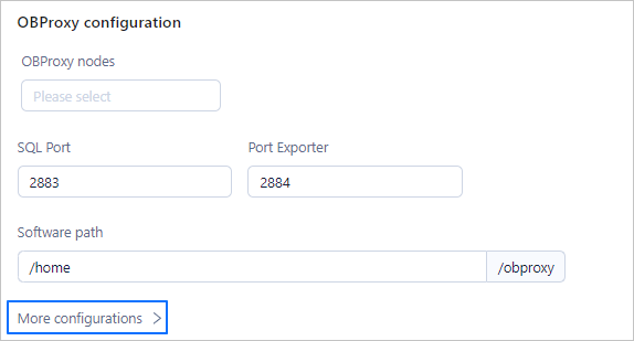

  4. Set OBProxy parameters.
    In the OBProxy configuration section, set OBProxy parameters, as shown in the following figure.
    OBProxy Configuration
    Parameter
    OBProxy nodes The IP address of the server where OBProxy is deployed. Only one IP address can be configured, which means only single-node OBProxy installation is supported.
    SQL Port The OBProxy listening port number, which is port 2883 by default. You can specify a custom port number ranging from 1024 to 65535. Make sure that the specified port is not already in use.
    Port Exporter The OBProxy Prometheus listening port number, which is port 2884 by default. You can specify a custom port number ranging from 1024 to 65535. Make sure that the specified port is not already in use.
    Software path The installation path for OBProxy, which is by default the obproxy directory in the home directory of the user who performs the deployment. You can specify a custom path, but you must have the read and write permissions for the corresponding directory.
    More configurations Optional. You can click this arrow to view and configure the OBProxy settings. You can use the automatically assigned values or customize each parameter.

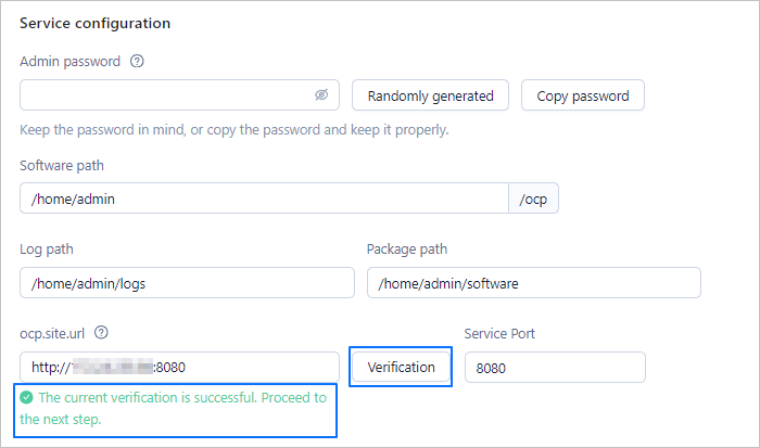

  1. Deploy service configuration.
    In the Service configuration section, specify the required parameters, as shown in the following figure.
    Service Configuration
    Parameter
    Admin Password The password of the administrator account of OCP. You can enter a custom password or click Randomly Generate to generate a random password. The password must meet the following complexity requirements:
    • It must contain characters of at least three of the following types: digits (0 to 9), uppercase letters (A to Z), lowercase letters (a to z), and special characters. Special characters are ~^*{}[]_-+
    To copy the password, click Copy Password.
    Only OCP V4.2.2 and later verify passwords against the preceding complexity requirements. In OCP of a version earlier than V4.2.2, the password complexity requirements are as follows:
    • It must contain at least two uppercase letters, two lowercase letters, two digits, and two special characters.
    • Supported special characters are ~^*{}[]_-+
    Software path The installation path for OCP, which is by default the ocp directory in the home directory of the user who performs the deployment. You can specify a custom path, but you must have the read and write permissions for the corresponding directory.
    Log path The log storage path for OCP, which is by default the logs directory in the home directory of the user who performs the deployment. You can specify a custom path, but you must have the read and write permissions for the corresponding directory.
    Package path The software package (for example, OBProxy and OBAgent) storage path for OCP, which is by default the software directory in the home directory of the user who performs the deployment. You can specify a custom path, but you must have the read and write permissions for the corresponding directory.
    ocp.site.url The web URL of OCP for external access. The URL must start with http or https and not end with a slash (/). The URL consists of the VIP or domain name and the port number, for example, http://localhost:8080.
    After you enter the URL, click Verification to test whether the URL format is correct. If the verification succeeds, the message The current verification is successful. Proceed to the next step. is displayed under the text box of the URL. If the verification fails, modify and re-verify the URL as prompted.
    Service Port The listening port for OCP. By default, it is set to port 8080, and it supports custom ports.

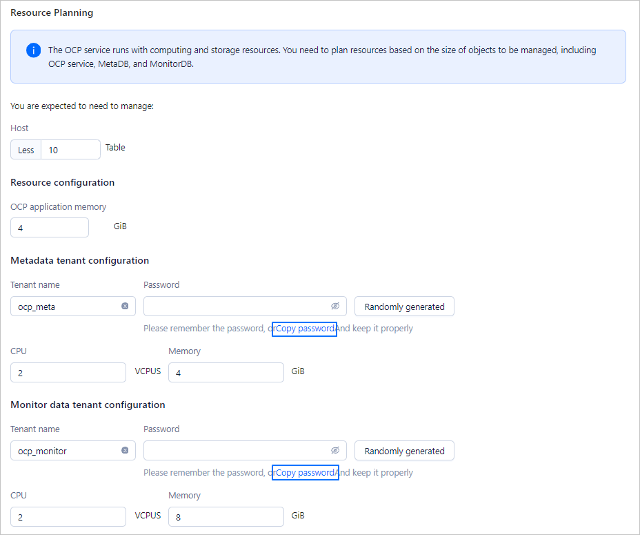

  2. Plan resources.
    During the operation of OCP service, there will be computing and storage resource overhead. You can plan resources in the Resource Planning section based on the scale of the objects to be managed, including OCP service, MetaDB, and MonitorDB, as shown in the following figure.
    Resource Planning
    The server deployment for OCP needs to adhere to the installation planning requirements of OCP. For details about OCP installation planning, see Installation planning in the OCP documentation.
    Section
    Parameter
    You are expected to need to manage: Host The number of hosts planned to be managed by OCP. By default, less than 10 hosts are managed, which can be modified according to the actual situation.
    Resource configuration OCP application memory The size of memory resources allocated to OCP-Server, which is 4 GiB by default. The configuration of memory resources is related to the number of hosts managed by OCP. For more information, see Host planning in the OCP documentation.
    Metadata tenant configuration Tenant name The name of the metadata tenant. By default, it is set to ocp_meta, and it supports custom tenant names.
    Password The root user password for the metadata tenant. You can enter a custom password or click Randomly generated to have obd generate a random string. The password must meet the following complexity requirements:
    • It must include at least two uppercase letters, two lowercase letters, two digits, and two special characters.
    • The supported special characters are ~!@#%^&*_-+=`\|(){}[]:;',.?/
    To copy the root user password for the metadata tenant, click Copy password.
    CPU The number of CPU cores allocated to the metadata tenant, which is 2 vCPUs by default. It can be modified according to the actual situation.
    Memory The size of memory allocated to the metadata tenant, which is 4 GiB by default. It can be modified according to the actual situation.
    Monitor data tenant configuration Tenant name The name of the monitor data tenant. By default, it is set to ocp_monitor, and it supports custom tenant names.
    Password The root user password for the monitor data tenant. You can enter a custom password or click Randomly generated to have obd generate a random string. The password must meet the following complexity requirements:
    To copy the root user password for the monitor data tenant, click Copy password.
    CPU The number of CPU cores allocated to the monitor data tenant, which is 2 vCPUs by default. It can be modified according to the actual situation.
    Memory The size of memory allocated to the monitor data tenant, which is 8 GiB by default. It can be modified according to the actual situation.
  3. Click Next Step in the lower right part of the page.
