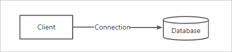

When you establish a connection between a client and a standalone database, there is only one physical connection between them, as shown in the following figure.
Standalone database
