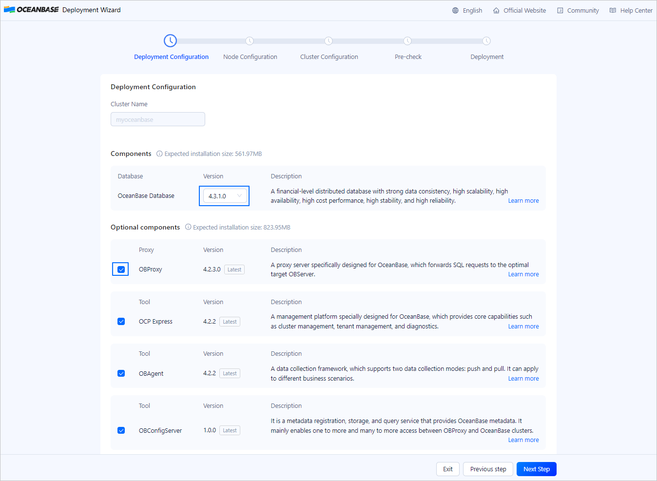

  2. Configure the deployment information.
    On the Deployment Configuration page, you can configure the cluster name, deployment type, and components to deploy.
    On the Deployment Configuration page:
    • The default value of Cluster Name is myoceanbase, which can be modified and must not be the same as the name of an existing cluster.
    • By default, all components are deployed, and you can choose whether to deploy specific components by clicking the check box next to the corresponding component under Optional components. Note that selecting OCP Express will automatically select OBAgent, and deselecting OBAgent will automatically deselect OCP Express.
    • Click Learn more in the Description column of a component to view more information about the component.
    • You can click the drop-down list in the Version column of OceanBase Database and select a version. For other components, the latest versions are displayed by default.
    Click Next Step to go to the Node Configuration page.

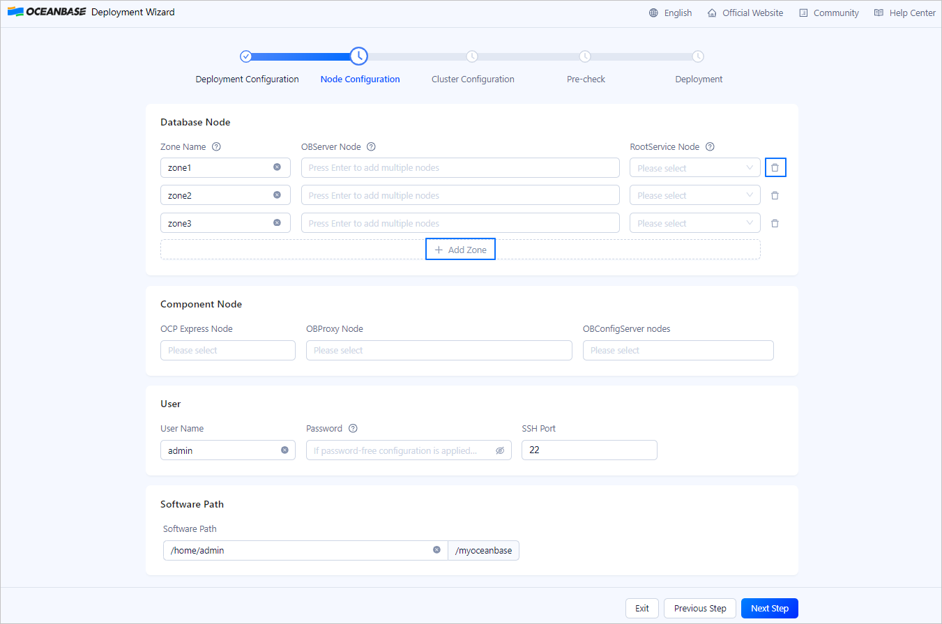

  3. Configure the node information.
    On the Node Configuration page, configure the database and component nodes, and specify the user information and software installation path.
    Node Configuration
    On the Node Configuration page:
    • By default, three zones are available for the database nodes. You can click + Add Zone to add a zone or click the delete icon to delete a zone.
    • For OCP Express Node, you can select the IP address of an OBServer node from the drop-down list or enter the IP address of a new node. You can select or enter only one IP address.
    • For OBProxy Node, you can select the IP address of an OBServer node or enter the IP address of a new node. You can configure multiple OBProxy nodes.
    • For OBConfigServer Node, you can select the IP address of an OBServer node or enter the IP address of a new node. You can configure multiple OBProxy nodes. If you want to deploy obconfigserver on multiple nodes, configure load balancing in advance.
    • By default, the value of User Name is the user who started the current process and the SSH port is Port 22. You can change the user and SSH port as needed. If password-free access is not configured for the nodes, you must enter the password of the specified user.
    • By default, the value of Software Path is the home directory of the user who performed the deployment. You can change the path as needed.
      After you enable More Configurations, you can configure the scenario parameter to specify a load type for the cluster. The default value of this parameter is htap.
    Click Next Step to go to the Cluster Configuration page.
