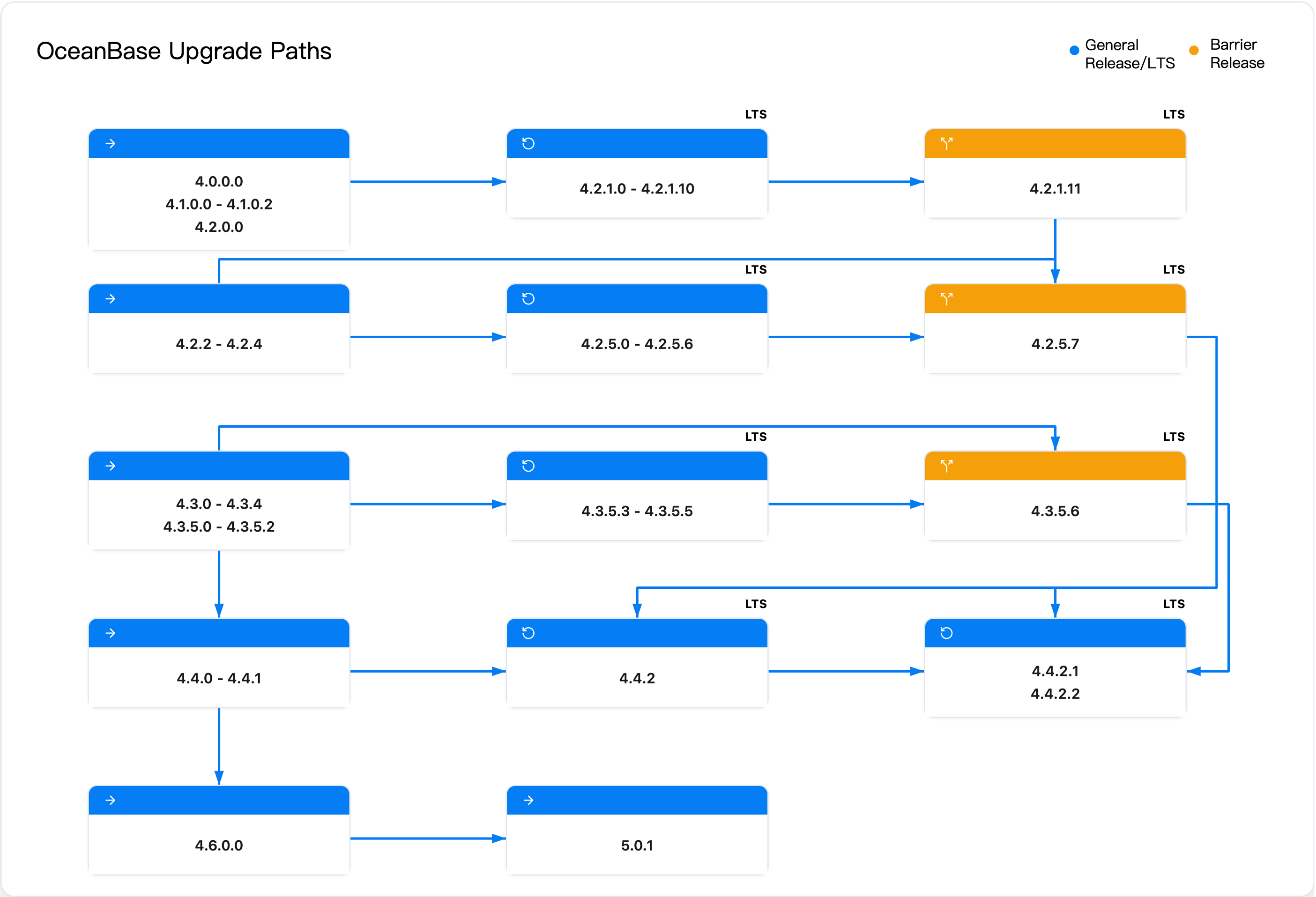

Upgrade path
- The upgrade path described in this figure is for reference only. For upgrade paths of more versions, see the
oceanbase_upgrade_dep.ymlfile, which records the version upgrade topology of OceanBase Database. - After you decompress the RPM package of the target OceanBase Database version, the
homeandusedirectories are generated in the directory where the RPM package is stored. The upgrade-related scripts and theoceanbase_upgrade_dep.ymlfile are stored in thehome/admin/oceanbase/etcdirectory.
oceanbase_upgrade_dep.yml file to confirm the upgrade path, see the Step 2: Confirm the upgrade process section in Upgrade OceanBase clusters.
The upgrade path described in this figure is explained as follows:
Upgrade paths for V4.2.x:
- You can upgrade from V4.0.0.0/V4.1.0.0 to V4.1.0.2/V4.2.0.0 to V4.2.1.11, and then to V4.2.5.7.
- You can directly upgrade from V4.2.2 to V4.2.4 to V4.2.5.7. You can also first upgrade to V4.2.5.0 to V4.2.5.6, and then to V4.2.5.7.
- You can directly upgrade from V4.2.5 BP7 to V4.4.2 or V4.4.2.1.
- Barrier versions: V4.2.1.11 and V4.2.5.7.
Upgrade paths for V4.3.x:
- You can directly upgrade each V4.3.x version to V4.3.5.6.
- You can upgrade from V4.3.5.6 to V4.4.2.1.
- You cannot upgrade a cluster of V4.2.x or an earlier version to a V4.3.x version.
- Barrier version: V4.3.5.6.
Upgrade paths for V4.4.x:
- You can directly upgrade from V4.4.0/V4.4.1 to V4.4.2 or V4.4.2.1/2.
- You can directly upgrade from V4.4.0/V4.4.1 to V4.6.0.0.
Upgrade paths for V5.x:
- You can upgrade from V4.6.0.0 to V5.0.1.
